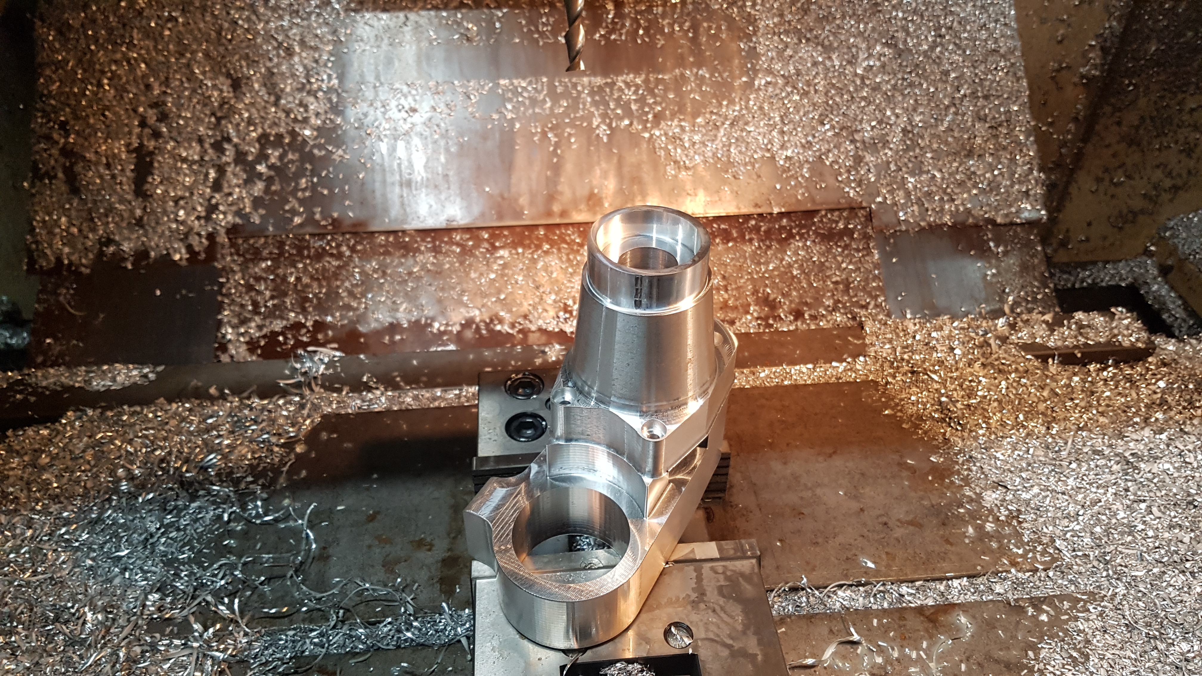

Flange for the Turbo manifold.
The mount figured and fitted on the engine.
Programmed in Mastercam
