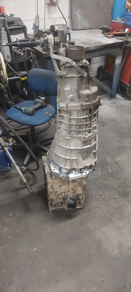

Post by Keith Phillips »
Gearbox is fitted to the adapter plate now....gearlever is 25mm further back....once fully welded and the input shaft modified I'll be onto propshaft and getting a clutch.
