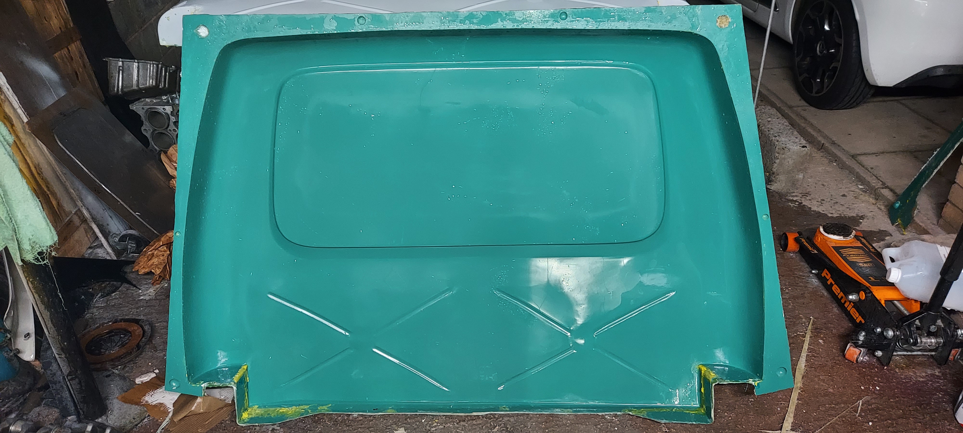

Post by Keith Phillips »
A new development for traybacking.....should be a weekend job to fit when I finalise it.
